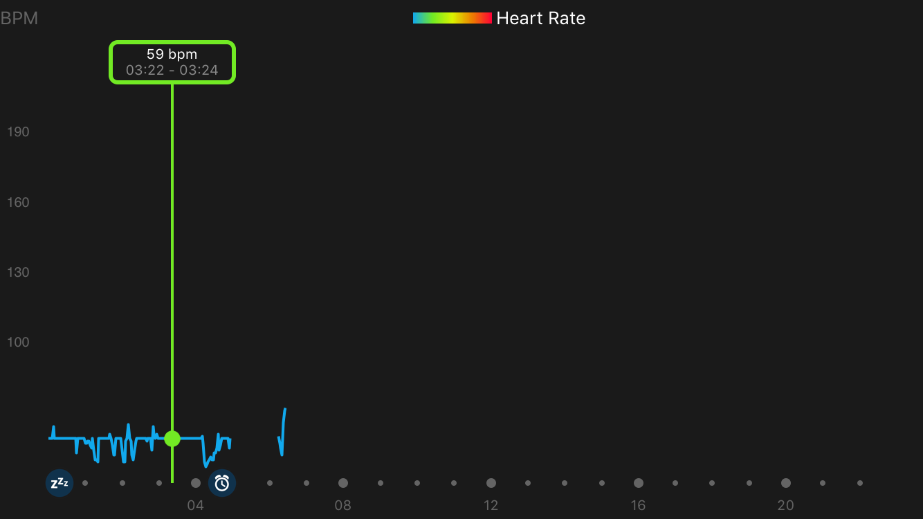

Sometimes the battery drains extremely (20% in 6 hours). The watch acts a little slow when scrolling trough widgets and my heart rate is mostly on 59 bpm. If I look in the Garmin connect app, I see flat lines of 59 bpm. I had this several days. 2 times I returned the watch in to factory defaults, every time with now effect. A return request was planned.

The problem sometimes occurs again and I now discovered that if the problem occurs it occurs after charging the watch. Last night for example I charged the watch till 23:00 when I woke up the next day, the battery was 21% down and the heart rate graph showed flat lines of 59 bpm (the graph is in the attachments). And if the battery is draining, it drains till 0% in a day.

ciq.forums.garmin.com/.../1368245.png
