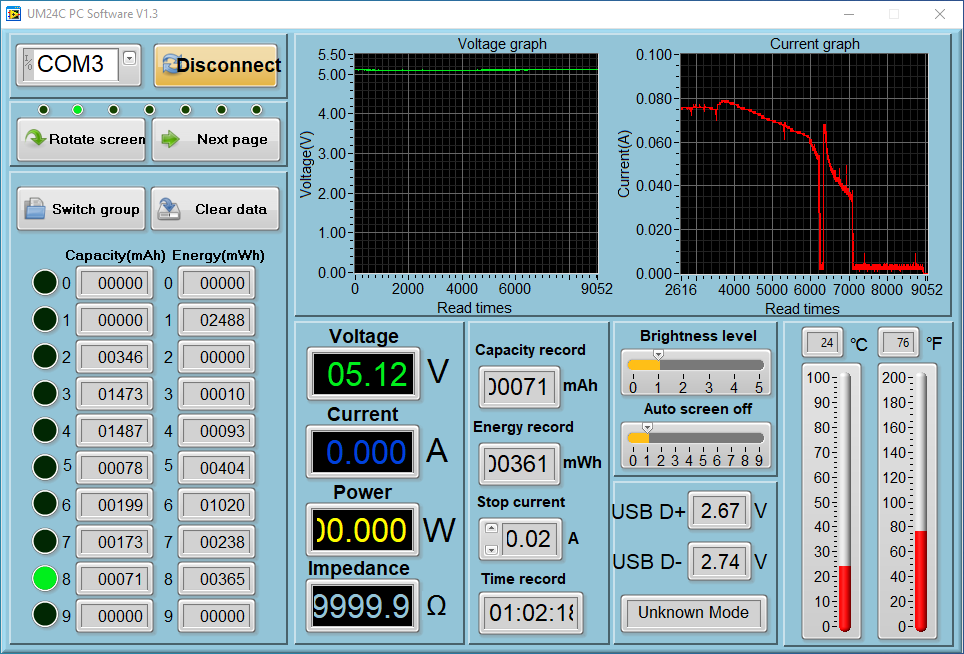

  • I've now had a chance to redo a charge using a much better USB tester. Can see the current graph on the right - gets to about 6220 seconds and stops charging for a bit.
    On the watch at this point, it shows '100%' which is between 80-100% thanks to the 45S only showing 20% increments?
    At 6220s, it stopped charging for about 2 minutes, then at 6332s resumes charging at 70mA
    Another 10 minutes later at 7100s, when it's dropped to 35mA it stops charging.
    I think unplugging the watch when it first shows '100%' means you miss about 12 more minutes of charging. Maybe why I was getting less battery life too.
    Also, using a power bank to charge can be a problem - if the power bank auto turns off once the watch gets to that first point where it stops charging.
    Summary - just leave it 2 hours to charge if you want a full charge.

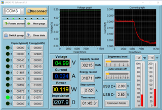

  • Just for comparison, here is my Garmin 245M - charges at 200mA then around 90 min has decreased to around 50mA.
    At that point (around 7500 x-axis) the watch shows 100% - but is actually 100 as the 245 shows 1% increments.
    It still charges a bit longer, levelling off at around 25mA.
    Continuous charge, with no pause of 0mA.
