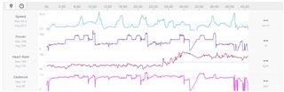

I have a FR45 and I rode my cycling trainer(TACX NEO) yesterday. And I got graphs as attached picture.
As you can see, heart rate graph is mess.
I heard that I should warm-up FR45 and my body.
How can I warm-up FR45 and my body?
Should I warm-up about 20 minute every time before I start Zwift?

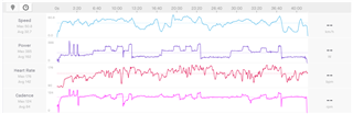

    Yesterday, I turn on HR Broadcasting 20 minute before I start Zwift aand I got the graph as attached.,
    And I satisfied with it.
    If you turn on HR Broadcast 20 minutes before you start workout and wear FR45 close to elbow, You can get proper graph.
