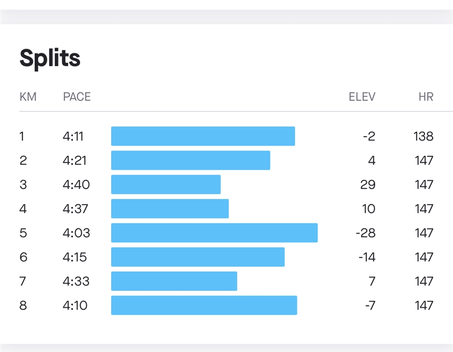

I have a Garmin forerunner 35. On a couple of occasions, at races, it automatically pairs to other peoples heart rate monitor devices at the start, and then when they are out of range it just gives me a flat heart rate reading from the point it can’t pick them up anymore.
    In that case the watch would rather revert to the built-in optical sensor, so I believe your issue is of totally different nature.

    to the second point, unfortunately it doesn’t revert to the in built one and instead just stays at whatever the last reading was. I’ll attach an example screenshot of when this has happened, in case that helps.

  • Ok, then there's something weird going on. The watch should not connect to external sensors on its own. And heart rate should not remain flat as soon as the sensor disconnects.
