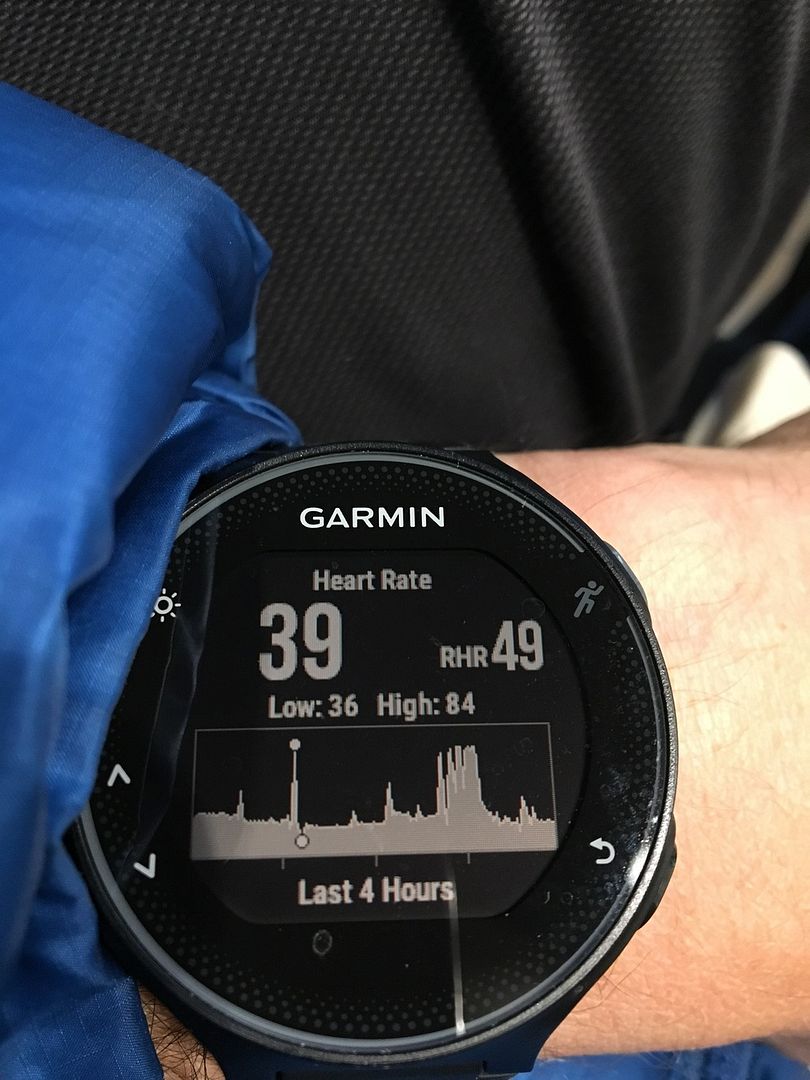

    I see the same behavior
    My 235 w 4.3 now shows RHR 49,while I'm staring at the display showing current HR 42
    The last version seemed to pick any instantaneous low and make it the RHR
    This version , so far, seems to say "no,your current HR is unacceptable, stop looking, we've decided your RHR is higher
