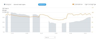

Looking on my latest ride in Garmin Connect I see a lot of strange dropouts in speed (the blue graph in the left pic). The Strava graphs look normal.
I ride on a bike lane at a steady pace without stopping, no dense trees or anything, using a Garmin 820 with cadence from my Assioma Duo power pedals.
What could the cause of this be? Bad satellite reception? Something changed in the plotting of graphs? I'm using GPS+Glonass.
In the right zoomed-in graph, with Cadence and Speed, it's clearly visible that I get cadence updates but speed dropouts around 32:20, for example. I haven't seen this behaviour previously.
