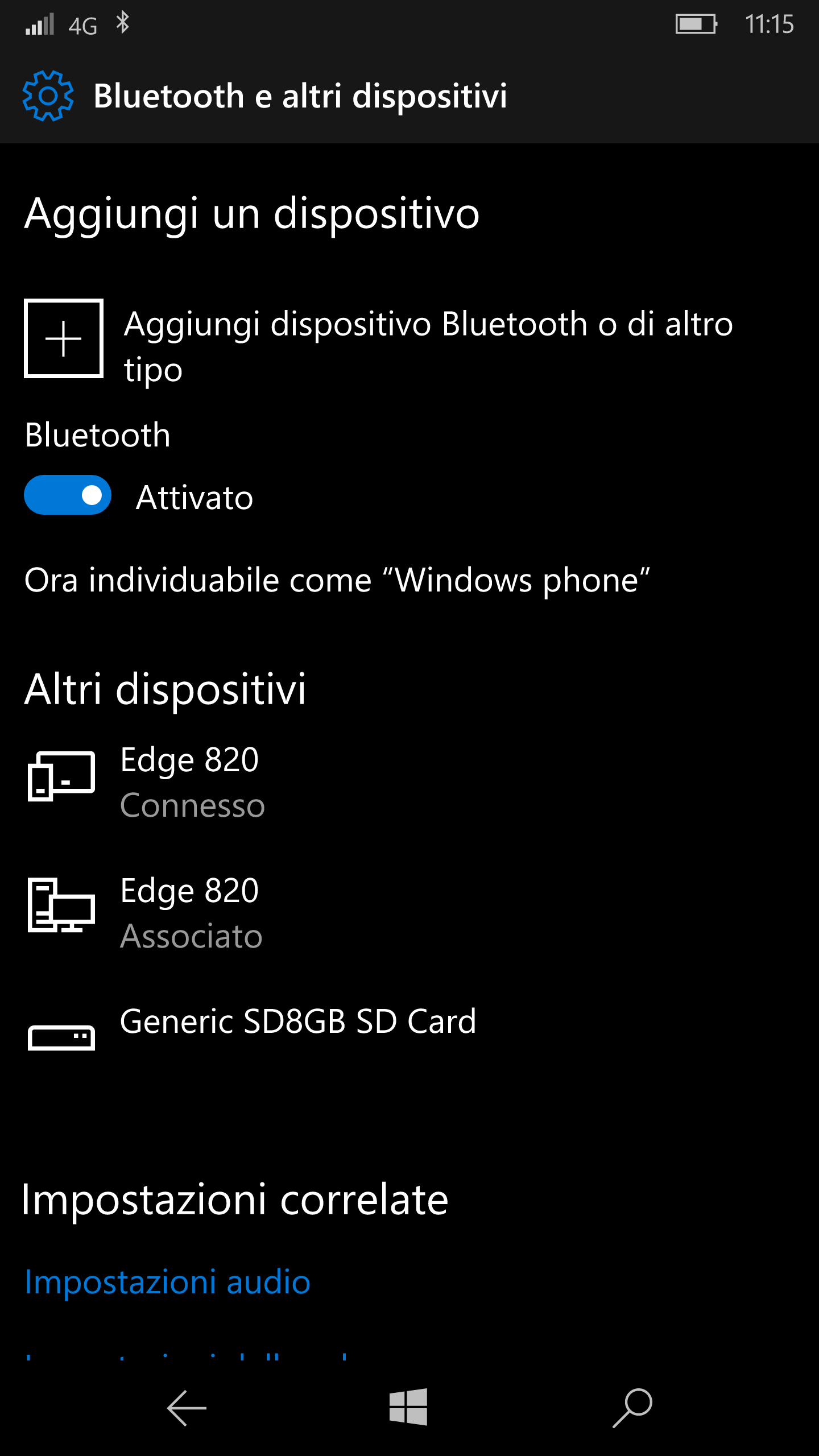

  • With Firmware v. 10.00 as for v. 9.0 bluetooth connection with Microsoft Lumia 950 xl fails. After many attempts I managed to connect the two devices but at the first activity the connection fails. I think it's a problem with GCM for windows because even if the two devices are connected, GCM sometimes does not recognize the bluetooth as activated. The only firmware that works with bluetooth is v. 8.70
    Now in the bluetooth settings of my Lumia 950 xl phone there are two entries concerning the edge 820 but only one is connected while the other is only associated. So even if GCM is connected, synchronization fails.
    ciq.forums.garmin.com/.../1398555.png
  • ^^^ there are supposed to be two BT associations. Note that the icon for each is different, one showing a tablet and phone and the other a computer monitor. I believe one is used for incidental communication with your phone during a ride and the other for transferring larger amounts of data, like up/down loading courses and activities. It might be normal BT vs BTLE, but I'm not sure of that.
  • I don't know why from fw 9.0 there are two associations BT, what I'm sure is that up to version 8.7 there was only one BT association and everything worked well, so I thought that the problems with GCM for Windows devices could derive from this difference between the two firmware.
