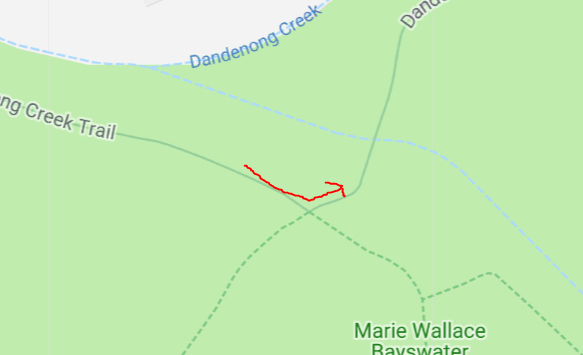

    Here's a challenge - I'm still struggling to get this one turn to pop up with a turn notification. For some reason the white direction arrow doesn't pop up where i need it. the route splits into a Y shape and needed to turn to the left.....On RidewithGPS i have dropped the pin right after the turn and there's cues generated that says Left but when i'm riding it the turn notification doesn't turn up. What else can i do to make sure that the turn notification will pop up for that turn?

  • Former Member
    0 Former Member over 6 years ago
    Thanks - i see what's happening now.....on further inspection the trail goes left but there happens to be a dirt trail coming off it. To the unit it doesn't recognize the dirt trail as another alternative so it did not give a turn notification......because it did give a turn notification about 80metres after the bend.....It's just that that's a junction that always confuses me as both paths are about the same....ciq.forums.garmin.com/.../1411195.jpg
  • "Roads" (ways) (paved or unpaved) available for routing should all be treated the same.
    So, you should get announcements for turns at intersections with dirt roads.
    It's possible that the unit might gnore ways where cycling is disallowed.
    It seem more likely that the issue here is the > 90 angle is too gradual. The units still should announce the turn.
