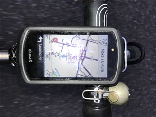

How do I add custom cues to the turn cues to identify food and sightseeing stops on the upper turn window with an audible beep?
When cycle touring, I want to have food stops and sightseeing locations pop up on the upper turn window with an audible beep on my Edge 1030+.  POI's are visible in a very small font, with no audible beep.  I have found that I can add Custom Cues in RideWithGPS that when I download the file as an FIT or TCX, I will get a beep and an alert on the bottom of the screen.  Unfortunately, all the turns in FIT and TCX format have an annoying round magenta turn arrow that takes up too much space on the screen in tight cities.
Is there any way to see the Custom Cues in a GPX format that does not include the round magenta turn arrows?

  • The map page top field (Guide Text) is only for device generated “Turn Guidance”. The Course Points are an optional and seperate independent navigation system. RWGPS will generate Course Points in Fit & TCX outputs for turns and custom created entries, the turns will generally duplicate those generated by the Garmin itself and can be confusing as you get both. You can clear the RWGPS created ones in the route creator/editor before you create your own custom ones and then you get the Garmin turn notification in the top of the map and your custom ones at the bottom of the map. Clearing the turn entries in RWGPS will also eliminate the “round magenta arrows” on the map for the turns leaving only your custom ones. If you are creating custom course points in RWGPS you must have a premium account and another feature available is moving the course point some distance ( you choose but say 50m) before the actual point, this is a benefit as otherwise you only get the custom notice as you roll over the point and not before.

  • So I followed your instructions, deleted the Course Points, and exported the route file with Custom Cues in a FIT format, and I got:
    • The turn instructions at the top of the screen with NO magenta arrows cluttering it up
    • A beep and the Custom Cue, abbreviated, on the bottom of the screen.
    • When I set up the Custom Cues, I assigned some as Left, Right, or Food, and I get a Left and Right arrow in the bottom field so I know which side of the road to look on, or a Food icon..
