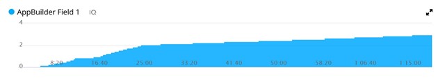

    Other thoughts... Your battery drain was about 7-8% per hour, so you could use that to estimate how long it'll last. In addition to displaying Training Effect (both Aerobic and Anaerobic) and Load/EPOC in real-time during an activity, you can also record Aerobic TE (but not Anaerobic TE or Load/EPOC) by using a ConectIQ app like AppBuilder5+. It won't prevent this issue of zero TE in Garmin Connect from interrupted recordings, but it will at least put a data chart in Garmin Connect showing how Aerobic TE increased during the ride:
