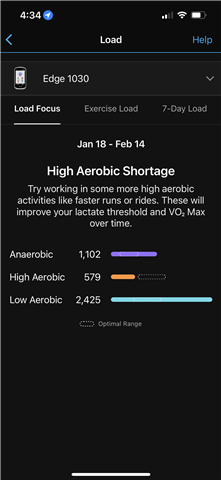

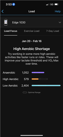

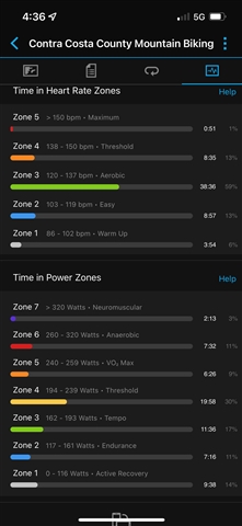

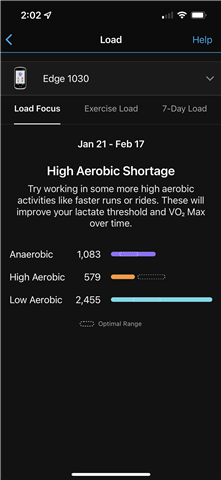

High Aerobic Load not increasing at all. Perpetual bogus "High Aerobic Shortage"!
Rides that absolutely should increase High Aerobic Load produce ZERO increase in High Aerobic Load Totals.
Low Aerobic and Anaerobic go up exponentially more. Most of the time High Aerobic does not increase at all.
Clearly several rides in a row with large blocks of Zone 4 power but High Aerobic load never went up even once.
Two of the Four rides were Threshold labeled and the other two were Base. This has been going on forever and it's very frustrating.

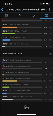

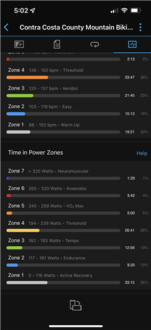

  • Confimring that it is STILL broken.  You can see this workout has vast majority of minutes in Power Zone 4 and 5 with very few minutes in lower zones. Not only did it get labeled as base but no gains were seen in high aerobic. So is there a solution? Are there beta code w/ a fix?  Do need to get a different device?
  • Hi BRGATESJR,
    what's noticable is that there is a lot of time spent in the Aerobic HR-zone and little time in the Threshold HR zone. It is worth checking if the HR zones are still the right ones for you w.r.t. the power zones. The HR-zones changed completely unexpected sometimes in my Edge1030Plus due to a 'forced' SW change.
    Still the High Aerobic should be more than zero considering the excercise you did.
    If you go to the 'homepage' of your Garmin Device in this forum then most of the time you can find at the top of all posts (or at least at the 1st page) if there is a beta-version available for your device..
    What also helps is if you post an issue of which you are pretty sure it's a bug, use the Tag option at the bottom of the page and put in the tags like 'error', 'bug' as much and as many as possible. The chances of Garmin picking it up are then a little bit bigger than zero.
    Both posting the issue on the page of the device and on the forum pages of Garmin Express and Garmin connect app may help because if the SW issue is e.g. also in Garmin express and/or Garmin Connect but not reported there as bug/error, Garmin doesn't pick it up
