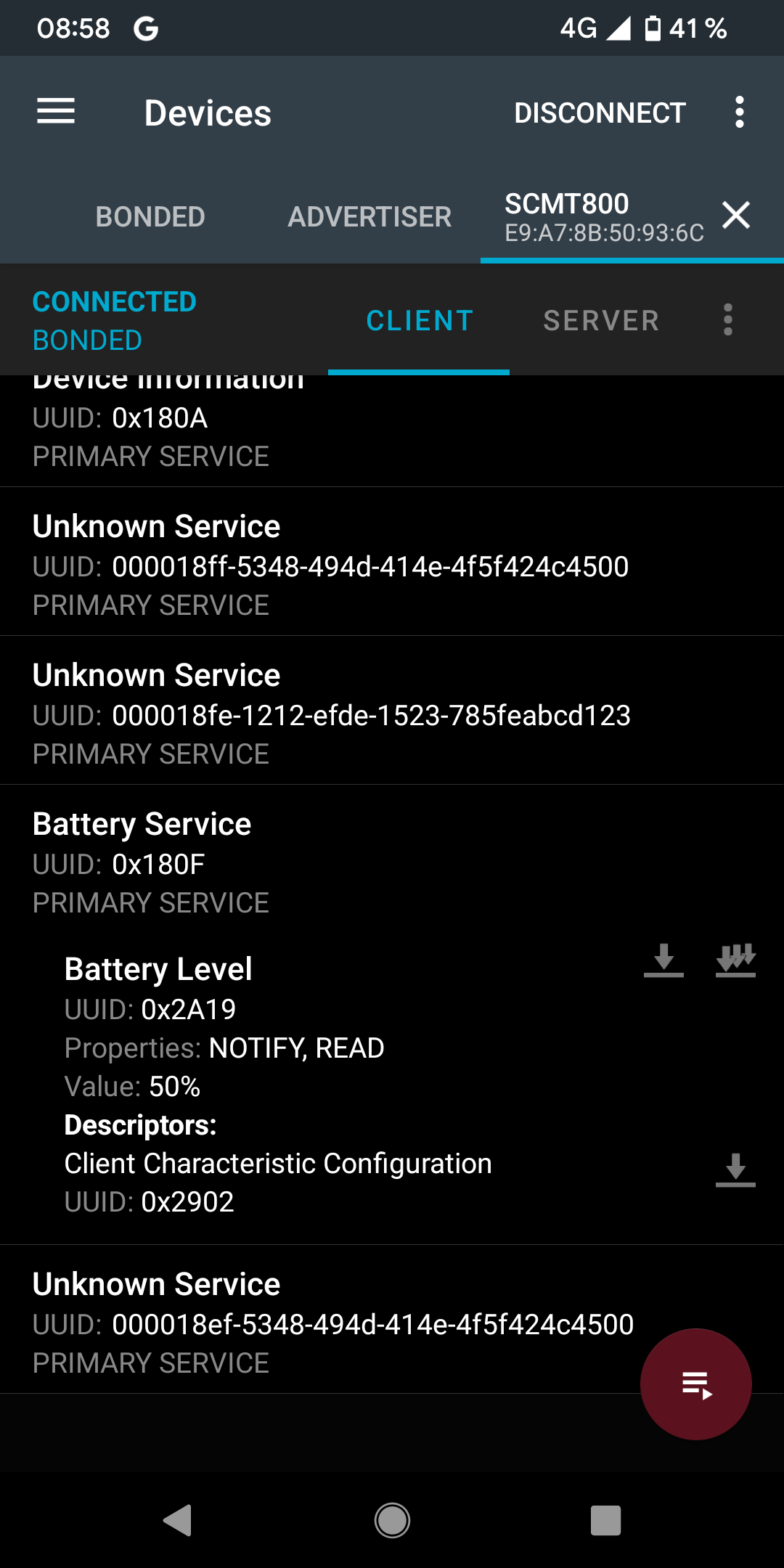

  • Hi, you can't (easily) do it trough ANT, but trough BLE it's very easy.

  • Hi, my answer was for someone who want develop a Connect IQ Data field with Di2 battery like sirfive.
  • This isn't possible on bikes using SC-E8000 display.
  • I'm curious why, it's because there is two batteries, something like that ? Maybe the information is just in another bluetooth ble characteristic.
  • Because SC-E8000 has a kind of bad Shimano firmware. Battery information is not avaible on BT. Anyway, SC-E8000 is not compatible with anything. It seems that it lacks ANT+ hardware. And you can't use EW-EN100 to solve this, because they are incompatible.
  • Thank you @Jarod46, you are right, the Bluetooth way could be an option.
