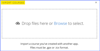

Using a computer you can import it into Garmin Connect Web as a course, then send it to your device using Garmin Connect Mobile app.
Thanks ... I found the icon ... when I try, it says "an error occurred" for every file. Well, I've run out of time before leaving tomorrow on tour #1 but I'll try some more before tour #2.
Just to be sure, you're doing the import course function, not import data. You said "I found the icon," which leads me to believe you tried to import as an activity which is different. There is no icon when importing a course.
If after this procedure you're still getting an error, zip the file and attach it to your post. We can take a look.
Hmm, no, I was using Import Data at the top of the page. Thanks for the shots, finally found it. Lo and behold, now it works. ;-)
