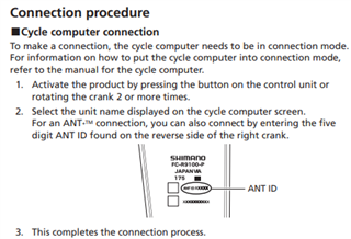

The owners manual says to use the Right side ID
Thanks, needed to pair them indeed in the 4iii app (producer of the specialized dura ace power meters...). cheers!
