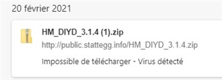

Thank you mcinner1
Here is a new challenge for me...
I'm going to try
Downloading the zip file http://public.stattegg.info/HM_DIYD_3.1.4.zip is not possible, even with McAfee disabled
