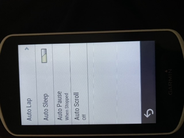

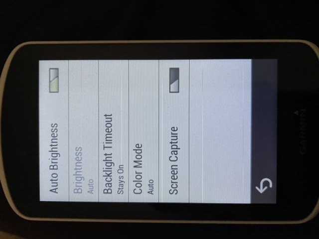

  • I've loaded your ...1641.zip activity file to fitfile repair tool and noticed:
    This strange elevation curves are recorded by the Edge internal barometer. (See Excel sheets). That's very strange and I have no idea where the correct elevation gain in Garmin Connect of 823 m comes from. (Elevation correction is not activated - if activated there is an elevation gain of 878 m shown.)
    What else I've noticed:
    -the battery consumption is very low for an Edge 1030 - less than 5% per hour. Question: in which mode do you operate the device? Where did you attach/stow it?

    Thanks for the response.  It’s too much of a coincidence for me that this issue began since the update. I’ve downgraded to version 10.00 and am riding in the morning, will upload a FIT file after that.  I ride with the Edge in the middle of my Stem, always have no issues with Barometer.  No special modes that I ride in either. I have HR, Cadence, Speed and Power sensors and connect my phone via Bluetooth too for notifications.
  • Ok, thanks for clarification!
    The power consumption of your device is amazing!
    (I have 2 Edge 1030 (normal) and they both eat about 10% per hour)
