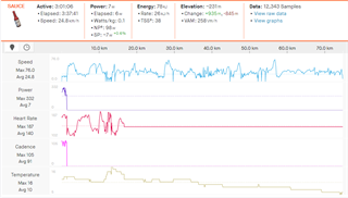

  • I've encountered a 4sec Sensor dropout of my powermeter on my Edge 1030 today. Same workout recorded by ANT+ Dongle on PC didn't show this dropout, so this is still an Edge issue, even with todays firmware. My Speed Sensor also dis- and reconnects 3-4 times during the ride. Very disappointing.

  • I'm having the exact same issues with my Edge 530. Garmin has replaced the speed sensor and my heart rate monitor. I recently bought vector 3 pedals ($1k CDN). Everything connecting and disconnecting constantly. The data is unusable.
    I talked to a Garmin rep today he said the problem lies with the Ant+ chip manufacturer. Sounds like a hardware issue - I would not expect it to ever get resolved without a recall.
    Garmin offered to replace my Edge 530 (with same faulty Ant+ chip),  but with all these issues and knowing what I do about hardware I think I am just going to ask for my money back for everything.
    Whoever heard of a tracking company that specializes in recording stats that can't record stats properly! Unsure how something like this could ever pass testing.
