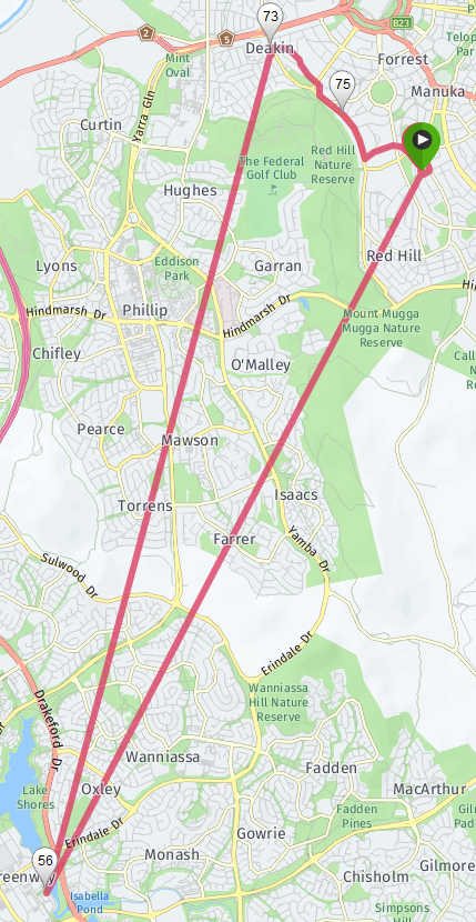

  • I just want to report that I did my first ride with 9.48 today. Connections drops were happening like never before ! At least half a dozen times during the work I get warning that Di2 and Garmin Radar reconnected, which means they also disconnected. I assume the other sensors disconnected as well, but I get no warning for those. So although the change notes says "Fixed an issue with sensor connectivity" that is absolutely NOT fixed, not even close.
