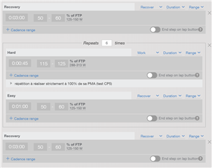

When I do trainingpeaks workouts on my hometrainer, the power does not correctly follow the plan. It looks like the edge1030 is not dirving correctly the hometrainer or it's not reading correctly the workout ??
Equipment : edge1030, elite drivo II, garmin vector 1 right and left, garmin cardio
No phone or pc connection.
The workout is synchronised to the edge through garmin connect.
As you can see on the below pictures, the actual power (pink) is not following the plan (blue) :
- repetitions 1, 4 and 6 are ok
- repetition 2 does not happen : the power stays at the easy level
- repetition 3 and 5 uncorrect : at the beginning the power goes very low, then it increases way over the 300W target and then it stabilizes at 300 but only the last remaining seconds...
Any idea of what goes wrong? What can I check or modify ?

    I did other similar workouts from TrainingPeaks. Same result : the 2nd repetition of each series goes wrong. And eventually other repetitions in the 3rd and 4th series.
    I also did a test with 3 series programmed differently : hard and easy steps, easy and hard steps (inverted order), single repetition series (3 series of 1 repetition). No change!!! The 2nd repetition is always wrong. Even with the single repetition series, the 2nd series goes wrong.......
