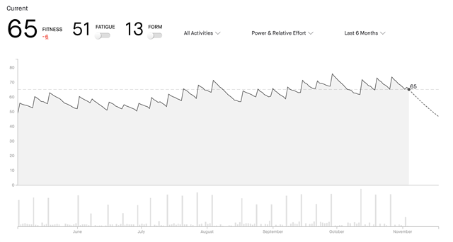

  • And why Strava is also measuring so different? Last ride is almost the same than previous three ones!!!!!! If I change the way of measuring to just Relative effort, this last ride goes up to be in line with the other. But if using Power... this is what I get.
