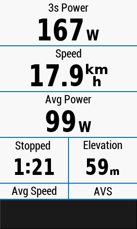

When climb pro is triggered I keep getting a black rectangle across the bottom of the screen which covers the bottom 2 data fields. It looks like a message popup warning box but it is blank.

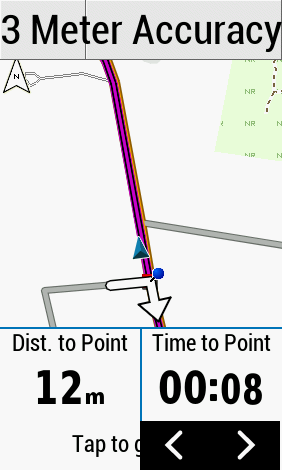

    The first 2 screen shots are when I changed to map notifications instead of text. I'm not sure what exactly happened on the first on but the 2nd one was a fairly common popup trying to tell me something about navigation but with instructions missing.

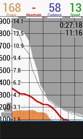

    The bottom 2 screenshots are with navigation set to text only and with climb pro off. The black instruction was coming up on all screens including a garmin IQ one I have.
