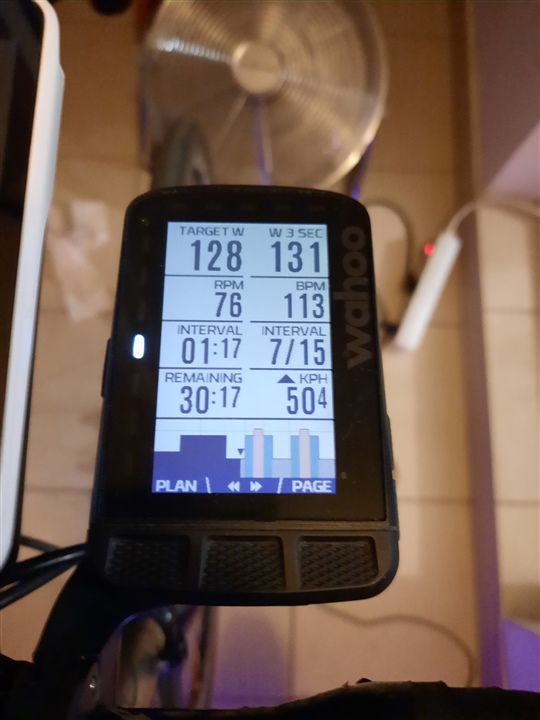

After setting a power target on my edge, the trainer immediately adjusted to the target but then lost the setting again after approx. 40 seconds (while the edge kept displaying the chosen power target) until I changed the power target again. Another curiosity, which might be related: the edge kept losing the connection for the speed-data from the trainer, see the attached image:
