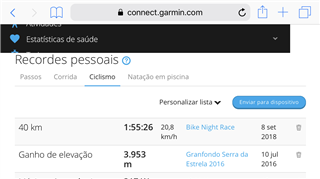

    0 Former Member over 5 years ago in reply to TexasChip
    It won't work. It has a bug since last Garmin Connect upgrade... If you erase your 40Km record and try to upload it again it will get the average of your total exercise divided by the amount of time spent to accomplish all.
    Ex: 2 hours exercise with 40Km average
    If you upload it to the record it will get a 40Km record of 20Km/h half of the time as it was made in 2 hours...
    You can test it...

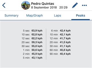

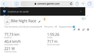

    Check it here:
    At least 40,4Km/h average for 77,73Km
    The 40Km record can't be correct... If for 77,73Km I've ride with an average of 40,4Km/h how can the software identify 20,8???
    Easy calculations:
    40,4Km/h -> 77,73Km so for the software in 40Km I've made 20,8Km/h Slight smile
    As you can see for 60 minutes the average was 40,8Km/h and with other softwares I can see that for 40Km I've made 58m16s... Can this be so difficult to understand and solve???
