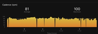

No I am using a EGDE1030, and i have power&cadans drops while i am riding.
the drops are mostly 10 sec ore less.

Ok I just did a test for Garmin. Turned on ANT diagnostics. Rode concurrently with both my Edge 1030 and Fenix 5xPlus. In a 7 mile ride with ZERO coasting I saw 7 different cadence and power dropouts on both the Edge and Fenix. Sending FIT files to Garmin.
