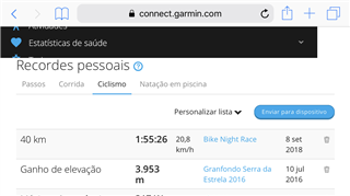

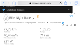

At 8th of September 2018 I've ride my bike on a road competition 2 hour resistance.

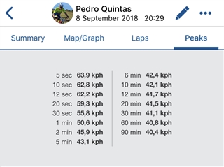

During this activity my speed average was 40,4Km/h and my best hour average was 40,8 Km/h (checked with TrainingPeaks).
The Garmin Connect app is not recognising this speed as a record.
Is recognising the speed average of all the 2 hours, but when I try to force it to the 40Km record it says 20,8 Km/h average... it obviously dividing the average 40,4 with the 1h55m26s that I've ride.
Can anyone help me with this?
Is there anyway I can force the correct speed record and not this ridiculous value that the app is making?

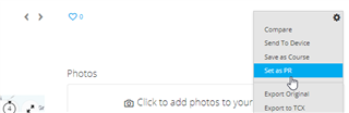

    From Personal Records page you can delete the one that it is selected by Garmin ,
    Then go to the activity that you think that was the fasted and from wheel on the right click on "Set an PR"

    But if you check my first image, when I do that, the software assumes that I've made 40Km in the total time of the activity, and so, it will divide it by the total amount of time.
    In this case I know that I've made 1h55m26s with 40,4 Km/h average
    I also know (checking on TrainingPeaks) that my best average in one hour was 40,8 Km/h
    The Garmin Connect assumes that 40Km made in 1h55m26s gives an average of 20,8 Km/h
    It's a bug I know but the issue here is that no one at Garmin is reaching my words and images and with Garmin Connect older versions worked fine...
  • Aha I understand , who knows, try to delete and assign again PR , maybe that will work
