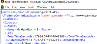

  • If you use a text editor you should see the name in the file near top, in name tags
    Using something like FirstObject might make easier to edit
    Here is an example
  • I used notepad and it does not look like that but i found the line <name> . Is this all i need to change?

  • Changing the name value between the tags is all you need to change. You might also want to change the file name when you save it.
    The Edge uses the <name> value to name a course unless that is missing from the file, then it uses the file name.
