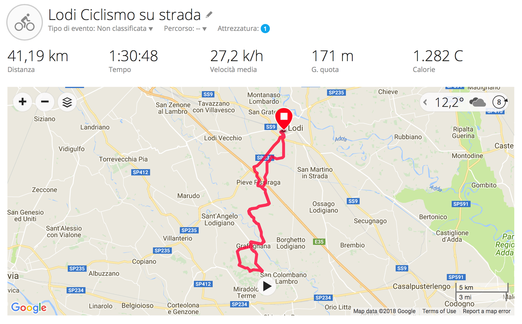

dash1e
over 7 years ago
It's strage, me and other guys have the same issue.
You can see in the picture a wrong calories count, generally the same track was about 800 cal.
I'm 1,72 m tall and my weight is 69 kg.
Naturally no issues before the recents firmware update. And no issues with devices before the Edge 1030.

dash1e
over 7 years ago
No issues at all on any of my rides on fw 3.90...
Do you use power meters?
Cancel
Up
0
Down
Cancel
0
Teriemer
over 7 years ago
Yes - always
Cancel
Up
0
Down
Cancel
0
dash1e
over 7 years ago
Yes - always
So with power meters you don't have the bug, try without it, and with HR only you will have the same bug that we all have
