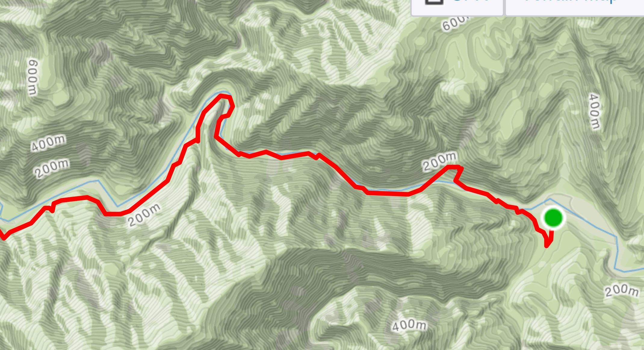

    I've just got back from first major ride with the 1030.
    Day one of a 3 day ride. Fisrt day its a posted 30km uphill, it recorded 26km. Next day a known 40km ride, it recorded 36km.
    Screenshot below shows me on north side of river.Track always on the south side.
    It meant my strava sement didn't match any others on the ride.
    Hope FW fixes this soon, should not be so bad on a new, expensive piece of kit.
    ciq.forums.garmin.com/.../1323037.jpg
