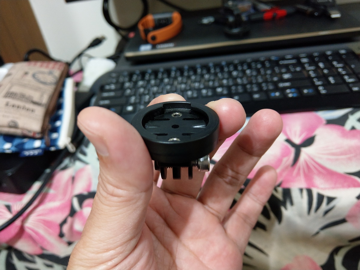

  • I put an o-ring in the bracket.
  • Using edge mount like this may improve the problemciq.forums.garmin.com/.../1334715.jpg

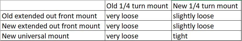

    That was my thought as well - as far as I know, the mounting is the same. Additionally, it was a tight fit at first but loosened over time. I'll admit that I removed and installed it quite often, as I ride daily and always removed the light to recharge it, but that use case should have been engineered in.
    My plan, when I receive the new mounts tomorrow, is to document how the old and new fit together (old quarter turn to new flush mount, old quarter turn to new out front mount, old flush mount to new quarter turn mount) before shipping the old units back to Garmin. That may give an indication on which side the issue lies.
  • Former Member
    0 Former Member over 7 years ago
    Attached is my analysis after receiving the new adapter and mounts. I decided to use the universal mount with the new adapter as that has the tightest fit and, hopefully, will be less likely to loosen with use. It seems that the issue lies with the 1/4 turn adapter, although even the new adapter on the new extended mount had a bit of looseness.ciq.forums.garmin.com/.../1342178.jpg
