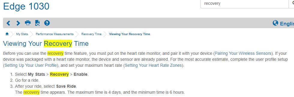

In the manual under Recovery Time it says, You can use your Garmin[SUP]?[/SUP] device with wrist-based heart rate or a compatible chest heart rate monitor to display how much time remains before you are fully recovered and ready for the next hard workout.
Then the next line down, NOTE: The recovery time recommendation uses your VO2 max.
In the section VO2 Max Estimate requires a Power Meter and under Performance Measurements it says Cycling performance measurements require a heart rate monitor and a power meter.
