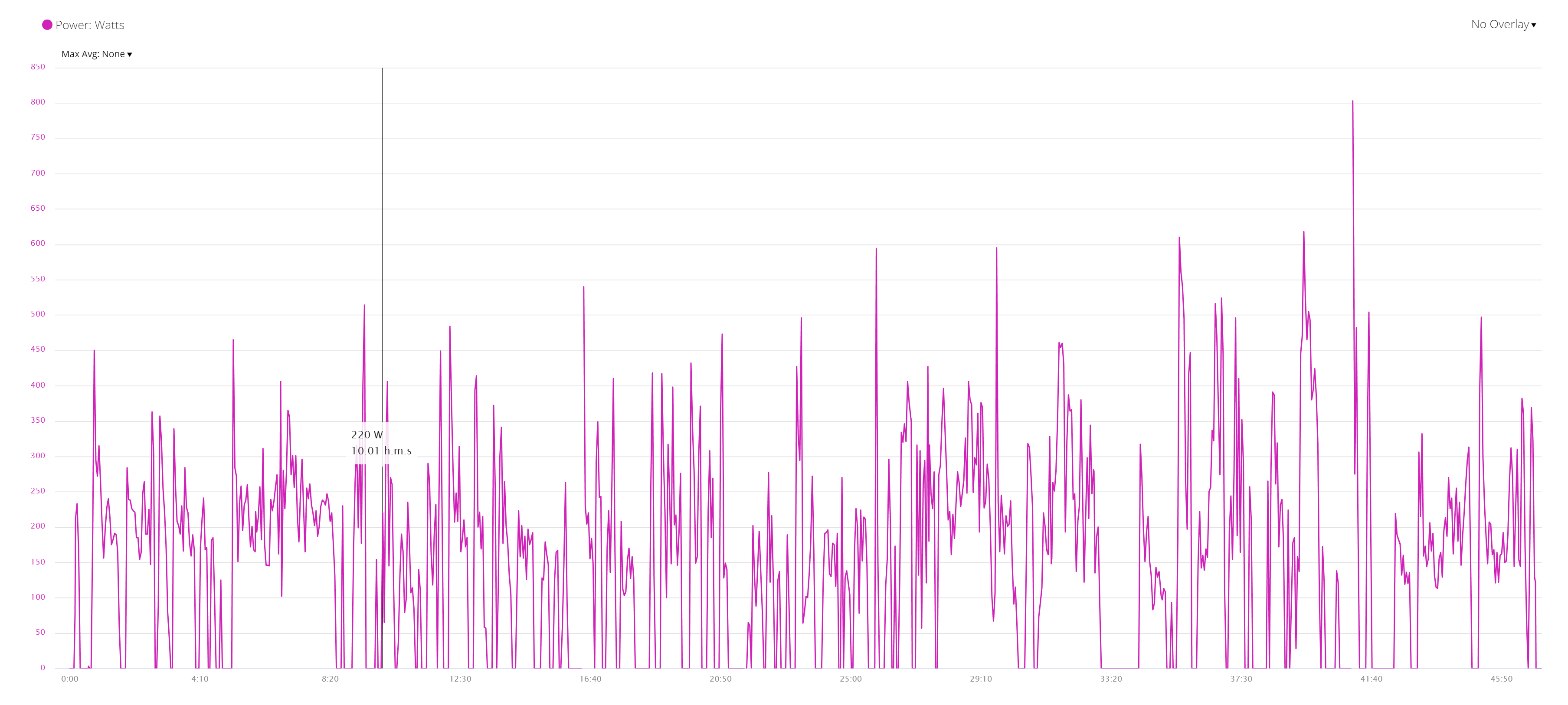

  • I had my Stages drop out a few times today on my ride with my new 1030. Looks like Garmin is using the same Ant+ sensor they had in the 1000. You would think they would have changed that.
