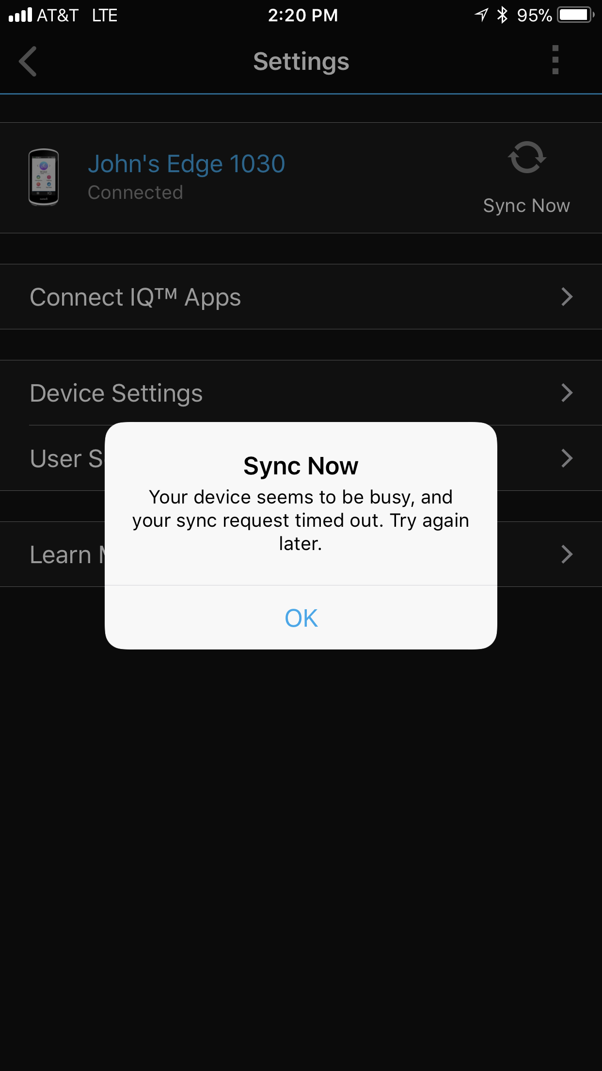

    I have had my 1030 for about a week now and gone on 4 rides. All is pretty fine and dandy except the unit won't stay connected to my iPhone 8+. It connects and says/thinks it's connected but won't relay text messages or notifications or upload to GC after my ride is done.
    Here's an image of what it keeps telling me.
    Wifi is disabled. I enable it when I get home and it finds my internet access quickly and uploads in a second.
    I need to unpair and repair the unit to my phone after each ride. That's terrible because the way you designed the new system makes it over complicated and drawn out.
    Can we please get this fixed?
    Thank you.
