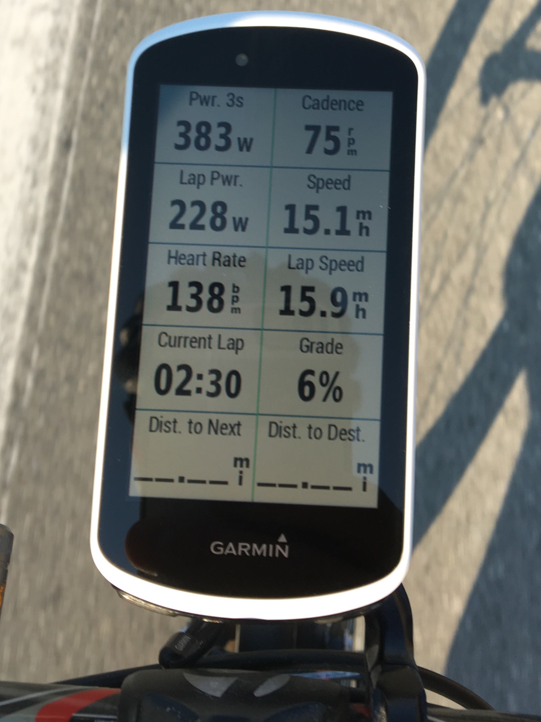

Some items I noticed today after a road ride and a trainer ride:
  • Screen seemed much crisper than the 1000. I have to note I have a screen protector on the 1000 that may dull things but the choice of fonts on the 1030 seemed less bulky. Sounds trivial but made the screen easier to read. Screen shot attached.
  • The new segment screen is nice. I hit a segment today where I improved by personal best. Once I was running ahead of my best it added to the screen the segment leaders time. Was nice to see both.
  • Edge will connect with the Varia HUD however the Varia will stop updating fields randomly. You can still swipe between screens they are just not updating. Rebooting the HUD and connecting fixed it the first time however after the second timed I could not connect. In addition, when it was working the grade on the HUD was wrong, would say negative when I was climbing at times and values seemed to max out at +/- 2%.
  • With the start/stop and lap buttons moved to the perimeter of the unit I found it hard to hit the lap button with the unit mounted to my K Edge mount. Going to pull the Garmin mount out and look to see if it gives more clearance. You can see the clearance in the photo somewhat.

ciq.forums.garmin.com/.../1247395.jpg

  • "With the start/stop and lap buttons moved to the perimeter of the unit I found it hard to hit the lap button with the unit mounted to my K Edge mount. Going to pull the Garmin mount out and look to see if it gives more clearance. You can see the clearance in the photo somewhat."
    Unbelievably, what aggravation improvement; now you have to use the Garmin mount that slightly increases the Edge mount. And the expensive and beautiful mounts of the Edge 1000, in the extension of the stem, can be thrown in the trash.
    If it is the case that the button placement is actually making it difficult for people to access them with an out front mount either garmin has dropped an ergonomic bollock with the design or its a cunning marketing ploy to get people to buy a remote. :rolleyes:
    Personally I can't understand why they've chosen to put them where they are even the L&R sides would have been better. It'll be even more difficult if you use a silicone case.
    I can only guess its for manufacturing reasons & not the woolly garmin response to dcr that it was to keep the form factor as small as possible.
  • @hotdogpartysausage
    You can now reach the keys with your thumb without letting go of the handlebars, was a statement by Garmin
  • Finally got around to putting the Garmin out front mount on the bike. Turns out it is no longer than the K Edge. Guess we will need to wait for K Edge to come out of a "new" longer mount.
