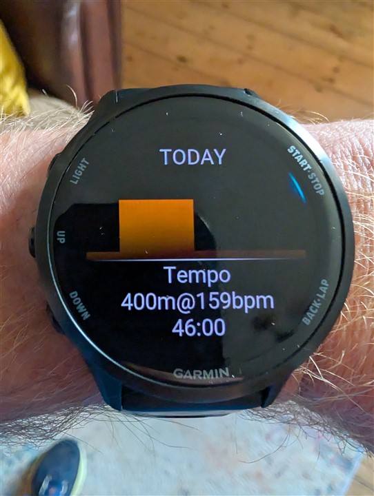

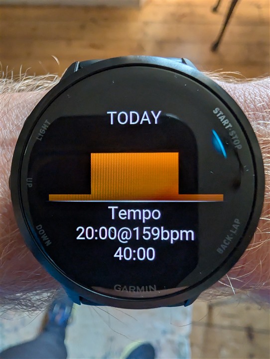

    I've attached a couple of recent suggested workouts which corrupt when selected as track runs. First is a 10min warmup; 20min tempo; 10min cooldown selected as a default run and as a track run.

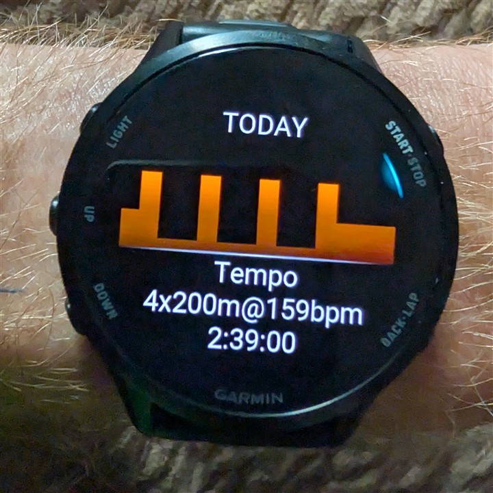

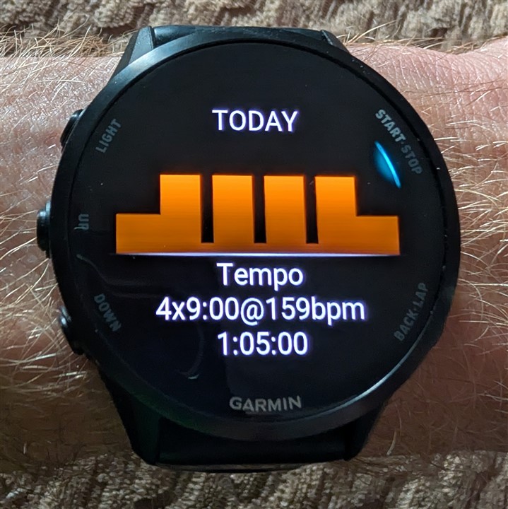

    Second is a 10min warmup; 4x9min tempo; 10min cooldown selected as a default run and as a track run.
