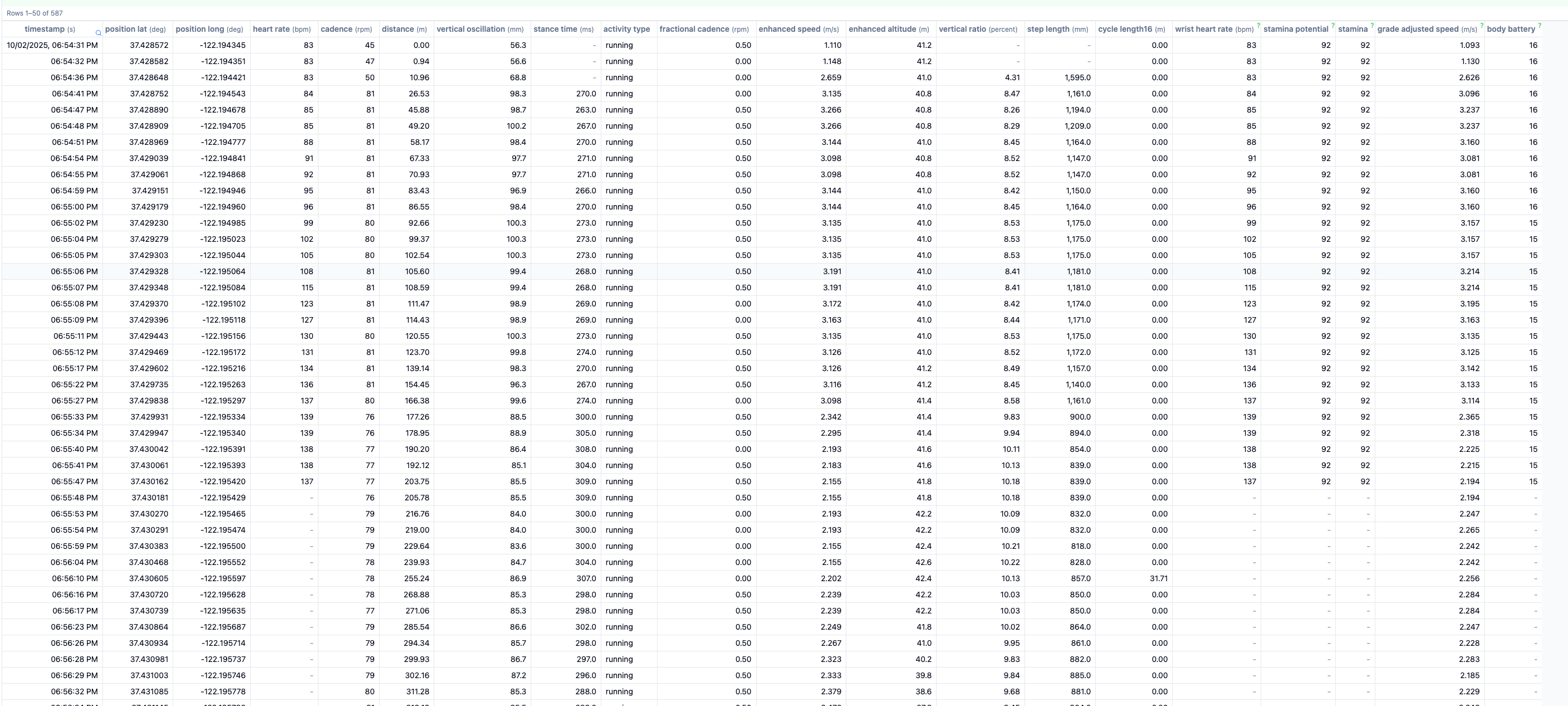

  • Ok interesting thank you. I haven't had this issue again yet, but what's interesting is when I look at the data if fitfileviewer, I see the wrist HR and HR columns being populated until the 06:55:48 PM row. Then going forwards all HR is blank.

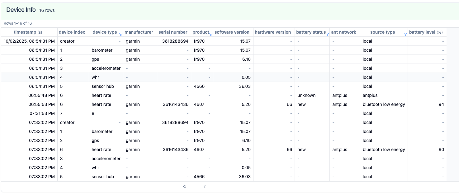

    Looking at the device info, that's the same time that my HR strap original paired with the watch. And the HR strap actually stayed paired with the watch the whole run, I see in Device Info it got logged again at the session end.
    I'm not sure if FitFileViewer actually displays the 3rd party HR column, but would be interesting to know if that data is actually there in the file.
    Records:
    /cfs-file/__key/communityserver-discussions-components-files/1059/Screenshot-2025_2D00_10_2D00_12-at-12.05.12_2F20_PM.png
    Device Info:
    /cfs-file/__key/communityserver-discussions-components-files/1059/Screenshot-2025_2D00_10_2D00_12-at-12.04.42_2F20_PM.png
  • Ok looking at a more recent run with the same strap, I see all three columns in fitfileviewer. Heart Rate, Wrist heart rate, and external heart rate. So something weird happened on my run, not sure exactly bc I was wearing my watch normally, but seems like when I paired the external heartrate it messed up my OHR and the strap wasn't reporting HR data either.
