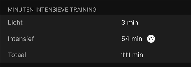

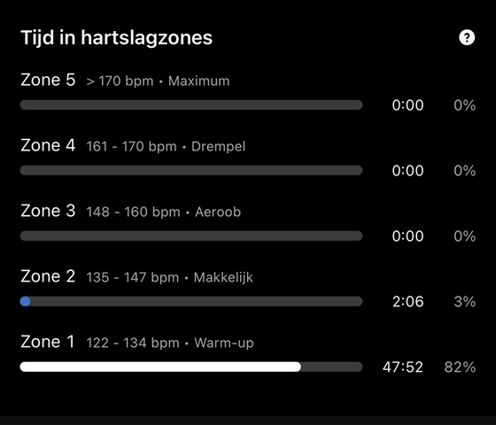

    But yesterday I did a slow 58 minute run with 48 minutes in Z1 and 2 minutes in Z2. Connct "gave" me 3 light minutes (what should have been 48), and 54 minutes vigourus (which I didn't had according to the 970).
    So I think that there is a bug somewhere in the 970 software/firmware.

  • I made another discovery yesterday. Again I did an easy run. This time not wearing the HRM600, but only my 970. Heartrate monitoring was off at the start, but after tightening the strap, the HR was equal to the HR displayed on my Apple Watch Ultra 2.
    Because of the HR issues at the start, the run showed 3 minutes of Z2 in Connect. All others HR where Z1.
    In the connect app, when looking at the details, I had no activity minutes. Which makes sense because it was a Z1 run.
