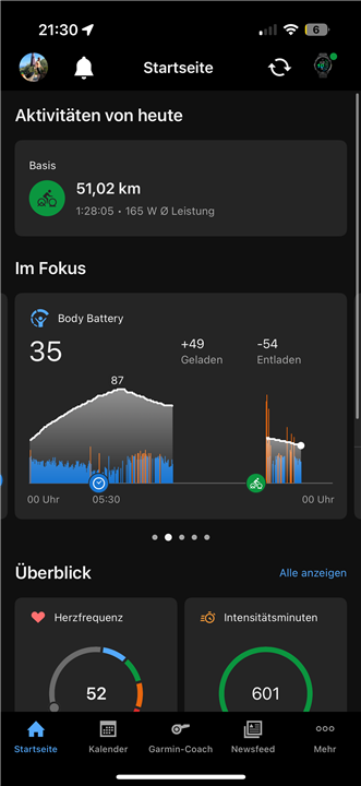

• Inside the watch today’s complete HR Data is available and cycling activity (51 km, 1 h 28 min, ended at 18:30) the HR trace is complete and looks normal.
- I wore the watch sinvestiert yesterday until now.
- On the watch itself I can scroll through a perfectly continuous heart-rate graph.

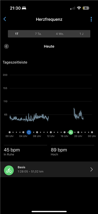

• In the daily heart-rate widget graph (Garmin Connect iOS App and web app), everything between 11:20 and 18:30 is blank—only the early-morning resting values and a short block after the workout appear until now. So the workout HR never shows up in the daily timeline, even though it’s stored in the activity file.
• Body Battery never changed from 11:20 to 18:30.
• For that exact period the watch and Connect both show “–”; it looks as if Body Battery logging simply stopped until the watch rebooted after the workout.
• Watch crash after saving the workout.
• When I hit save at 18:30 the watch froze, rebooted, and then synced. After the reboot, HR and Body Battery readings resumed—but the gap from 11:20 to 18:30 remained.
