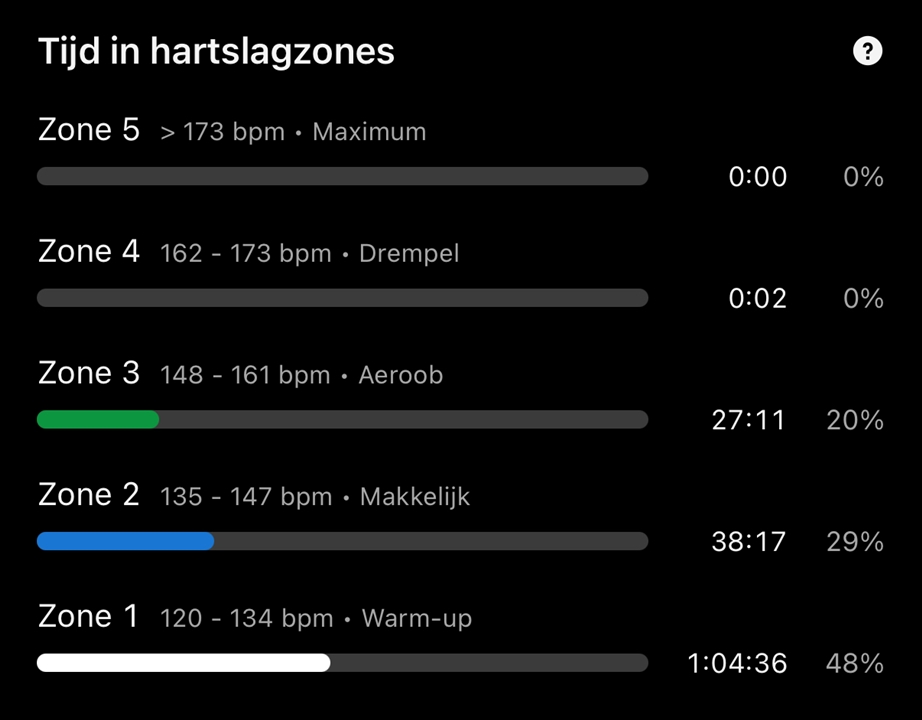

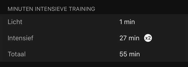

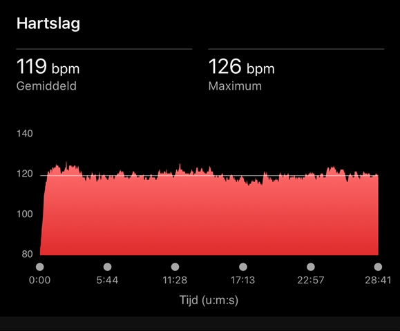

Since one week (starting June 23rd), when running, my intensity minutes in Connect are off. Sometimes they seem ok, but on other runs they didn't. I did 5 runs this week, and 2 seem OK, The other 3 aren't. Those 3 runs I ran at low speed, and thus low heartrate. basically zone 1 and only very limited zone 2.
On these 3 runs Garmin shows 1 minute of moderate, and all the other minutes as vigorous. So that would mean Z2 and Z3, but like I said, I only ran Z1. In the connect app my activity minutes are now doubled. I use my 970 together with an HRM600 since the beginning of June, and can't remember changing anything in the set up this week.
In the Connect app I've configured the setting for activity minutes as:
- Moderate Zone 2
- Vigorous Zone 3
My zones in the connect app are:
- Z1 from 122 to 134
- Z2 from 135 to 147
- Z3 from 148 to 160
On the 3 runs where the minutes are incorrect I didn't exeed a HR of 135 BPM.

    The issue with the wrong intensity minutes seems to appear when I use the 970 with a chest HRM. I started using it together with the HRM600, and noticed that Z1 minutes are calculated as Z3. This week I tried the 970 with my older HRM-Pro Plus, but got the same result. So it seems that issue is appearing regardless which HRM you use. And it lookes like it is a Forerunner 970 problem.
    When I use the 970 as a stand alone device, all is well. So strange.
    Last week I did another discovery. After a run, I saved the run and immediatelly looked at the data. The intensity minutes were spot on. But ..... When I looked at the run data only 5 minutes later, the intensity minutes were off again. After processing the data (by Garmin or the Connect app?) the Z1 minutes were seen as Z3, thus giving me way too much intensity minutes.

    Today (August 31st) I did a long run (24 km) in preparation of a marathon I will be running in November. And the IM’s equal the minutes I ran in Z2 and Z3, as you can see in the screenshots below.
    So somehow the data in the 970 was uploaded to Garmin Connect correctly, but after the data of the HRM600 (or my HRM-Pro plus) was uploaded/processed it messed it up. That explains the fact that the IM’s right after uploading were OK, but changed after some time afterwards. The HRM data was uploaded/processed with a delay.
