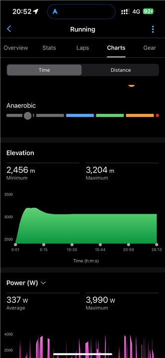

So I’m 3 runs into my lovely Forerunner 970, and noticing elevation issues on every run. I have calibrated the altimeter multiple times, and when I check during non activity it’s correct. But just after starting a run, Garmin thinks I’ve climbed 2500m in height in just a few hundred meters distance: not physically possible.
This is what my Garmin measured
Vs after I updated the activity to use the professional survey elevation data
This one is correct: 5k race that was pretty flat, just some very minor little inclines and declines
