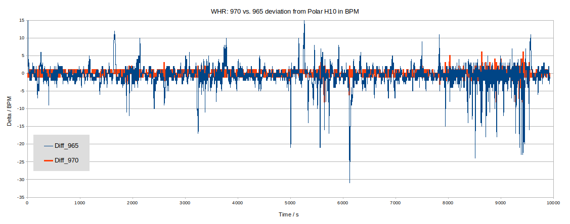

I had been pretty disappointed with the 965's WHR response & accuracy, which was one of the main reasons for me to try the 970. Now today I took both on a 5h trail run, with the 965 additionally recording from a Polar H10. I'll try to attach a graph where I plotted HR deltas of both watches in relation to the H10 and hope it'll work, these are the first 2.7h only, because then I made a break and forgot to pause the 965, so recording got out of sync with the 970. 970 is running 6.17, 965 23.20. Avg. HR was around 135, max. at around 160.
I have to say: WELL DONE, GARMIN!
Best,
r.
