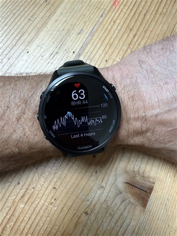

The heart rate zone keeps displaying automatically on watch face about every 5 mins. Is there a way to stop this displaying without switching off heart rate monitoring?
Seems like your watch's touchscreen is experiencing "phantom touches". Normally you would only be taken to that screen from the watchface if you long-press the heart rate data field, but since you're obviously not doing that, the watch may be detecting non-existent touches.
Have you tried turning the watch off and on? Hopefully this will recalibrate your touchscreen.
- Hold the LIGHT button briefly to open the controls menu
- Select the Power Off button and confirm the prompt
- After the watch turns off, hold the LIGHT button for several seconds until it turns on
If that doesn't help, you might want to contact Garmin Support at https://support.garmin.com/ or [email protected]
