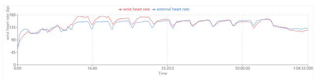

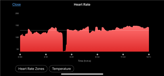

Since one month ago or so, my Garmin Forerunner 965 has been tracking my heart rate deceptively bad, considering its price, both in running; have had cadence locks for 20 minutes, normal HR values and when pausing it goes back to cadence lock and surprisingly, for indoor cycling, where there's no arm movement at all.
This seems to happen more when I start the activity with a heart rate more elevated than usual, and then reports around 115-125 when the HR as checked by a chest strap is around 165-170.
I am aware that wrist-based heart rate is not the most accurate thing, but it is honestly too bad for the price I paid for it and considering that HR is the base metric for all other estimations and data (calories, VO2Max, training load, endurance score, RHR, HRV, stress, intensity minutes).
Any fixes, to recalibrate the sensor (apart from using a chest strap, which isn't always available)? Removing the watch and putting it again does not work.
  • Interesting chart. The real question is what does the "(activity) heart rate" chart look like for the 1st 12 minutes? In other words, we can see that the wrist HR data was bad, but did the watch choose to use the wrist HR or external HR for that period? (I'm not implying that it has to be one or the other for the entire period, of course.)
    I ask because you obviously have dynamic source switching enabled (otherwise you wouldn't get "external heart rate" and "wrist heart rate" in your FIT file), and in my experience, the watch will sometimes choose wrist HR for short periods during an interval workout when the wrist HR data is objectively worse than the external HR.
    I've never seen such a huge deviation between wrist and external HR though (both in terms of magnitude and length of time).
    Maybe the problem is that it was cold outside and you weren't warmed up?
  • The heart rate displayed and recorded was from the external sensor for the whole time of the activity.
    It was a bit cold when we arrived 30 minutes before the start, but it was pretty nice weather when we started, and we did warm up as well.

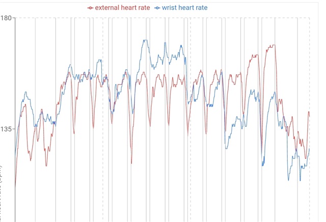

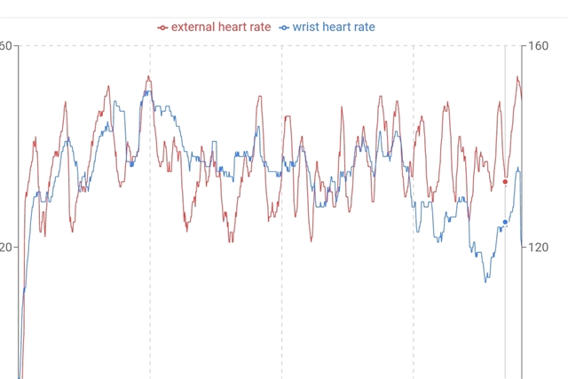

  • I usually get graphics similar to those, and same thing happens to most of my tempo/threshold runs, it gets stuck at around 130 bpm and then suddenly jumps to 180 bpm as expected. Tried everything: taking the watch out for a couple minutes, switching it to the other wrist, cleaning the HR sensor, swinging my arm, and starts reading actual data when it feels like it.

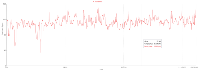

  • Get the same issues when doing gym, got a 33 bpm low peak for some reason (I was about 100 bpm). It has gotten so unreliable that it almost seems a random number generator just like Strava's estirmated power

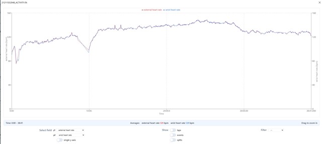

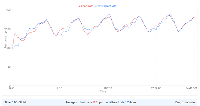

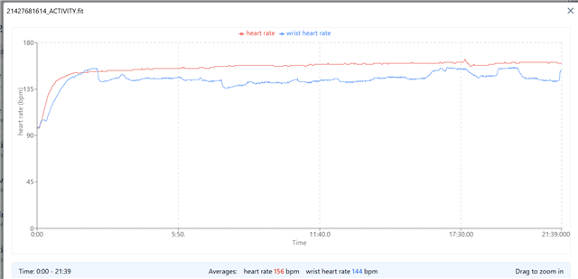

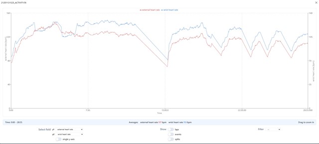

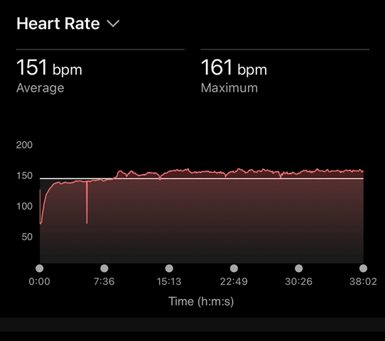

  • To me, it seems to be a temperature thing. Running indoors on a treadmill is spot on. However, running outdoors shows a slight discrepancy between my HRM Strap and the watch, with a 4-beat lower average heart rate on the watch.
    In the pictures, the differences between running at 2 °C and indoors are shown.
  • it would be easier to compare if you switch "single y-axis" on. Wink
    But nevertheless: In your first graph you can see that it took the typical 5 to 10 minutes to get in sync.
    When it's cold i am not even able to use the wrh when hiking - it will lock to my cadence most of the time (regardless of the position of the watch on the wrist). Even when i am shopping outside in the winter i know that every calculation the watch is doing is wrong because of the erraneous hr recorded (or in other words: almost every feature of the watch is useless because of its huge deviations from the reality).
