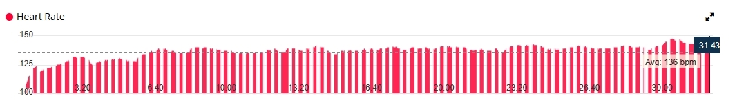

I have noticed over the last few weeks that my ANT+ sensors are dropping out every few seconds. HRM Pro, Bike Speed Sensor, Bike Cadence Sensor. All new batteries and have reconnected them.

Can you see if those drops happen at the same time on all sensors? If yes, then I'd suspect a hardware issue in the watch, in which case contact Garmin support for a warrantee replacement
