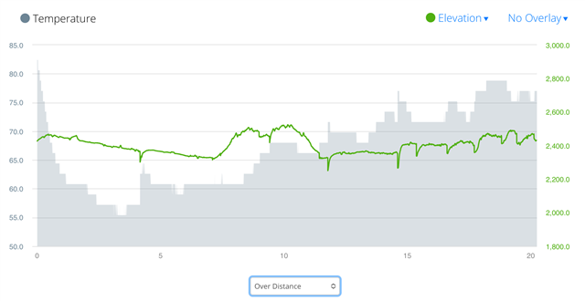

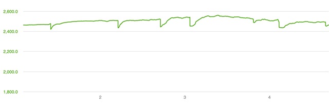

Fortunately- I can select the DEM corrections to get proper elevation data, but the watch data now has a lot of discontinuities and errors.
Anyone else seeing this? Or do I need to call Garmin about my watch.

The altitude at the start is exact, but the end is mostly strongly different even if I finish exactly at my starting point.

Used to be a big issue I would mainly notice while biking, if I went into a gas station, coffee stop, brewery... etc then I would restart and my elevation would be off by 10%+ you could see it correlate with the onboard temperature sensor going from cool outside... then paused and warm inside... to back outside. The elevation would adjust after maybe 10minutes down the road. They should have temperature compensation to account for this.
My most recent ride with Edge 540 adjusted pretty well for that, went from riding at 54°F and 834ft ...long stop inside, came out and was reading 68°F and 843' - so not much a issue for me. You are seeing much bigger spikes from just quick stops. Having watch exposed (not under clothing) would help. BUT... this shouldn't be happening. Are your temperatures from watch looking good generally? Up down etc? Seems like the autocalibration is not working. By chance are you running with phone with you and Garmin running in the background? could also help maybe? idk too much about the autocalibration. I know I get a notice on my biking headunit when I start and activity. ...?

Yeah- I was running with my phone and garmin was probably running in the background. How would this affect things? There does appear to be some correlation with a degree or so increase in temperature when I stop. From today’s long run.
I believe having the phone around at the start or during can help with syncing/calibrating to a 2nd source of data to offset the temperature drift. BUT... that is a guess or maybe how it was. Now it might utilize your watches Map information for location/map-elevation to adjust your sensor calibration. I am not sure how that process works.

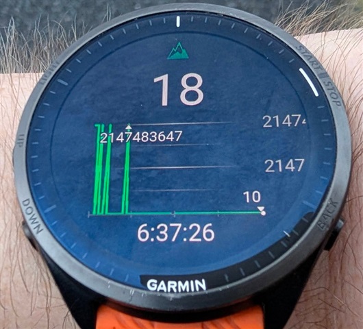

This is the elevation bug I see when I use the hiking activity, it's never shown up when cycling or running. I reported it to Garmin but they claimed it was a once off, it's not!
I think you really did climb 21 billion feet on your hiie
Always the problem with the altimeter even with the 26.08. version.
If it's of any help to Garmin in fixing the bug, that number (2147483647) is 2^31 - 1.
