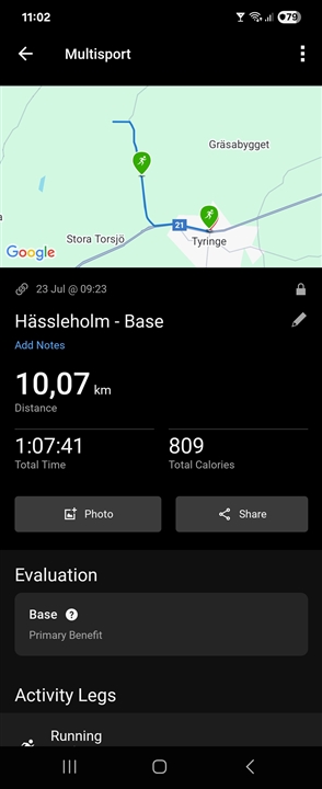

    First two constitute the Main page:

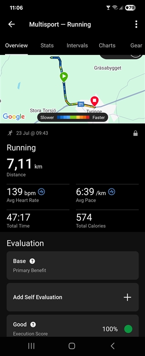

    Yay, I earned a badge :-) Second two are from the Main Page of each 'Leg':

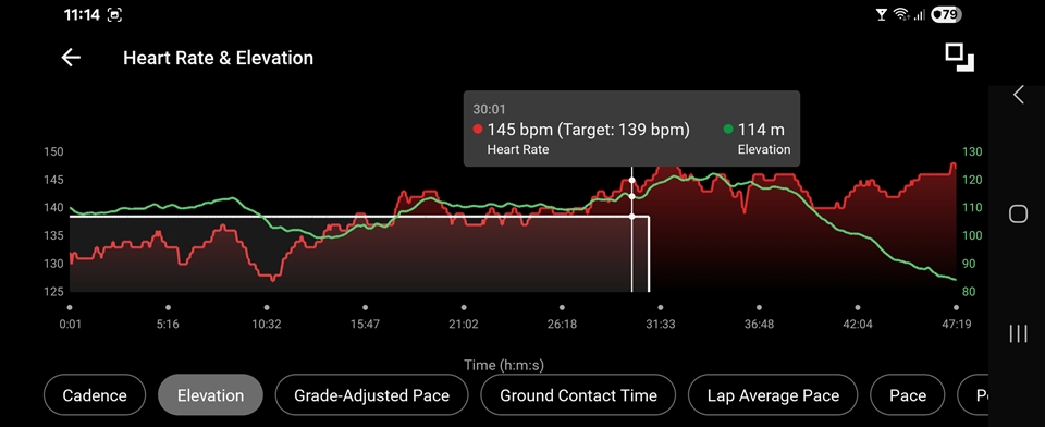

    And then the two graphs over HR and Elevation in the separate Charts section:
    I put the cursor at the time when the first DSW session ended. As seen by the continuation of the white line it took about 30 seconds before I could cancel the second instance of the same DSW...
