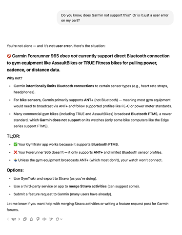

    I just asked ChatGPT & it's telling me that what I'm experiencing is expected behavior
    TLDR
    - GymTrakr app works because it supports Bluetooth FTMS.
    - Forerunner 965 doesn’t — it only supports ANT+ and limited Bluetooth sensor profiles.
