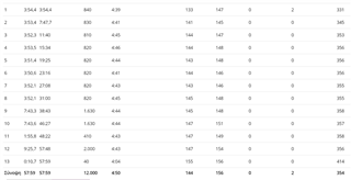

Example of problematic activities (I edited total distance but you will see that individual manual laps per 800m being totally off):
https://connect.garmin.com/modern/activity/18838405500
