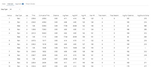

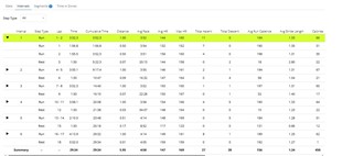

After upgrading to from the 945 to the 965 and transerffing all my PRE PROGRAMMED workouts i noticed the following.

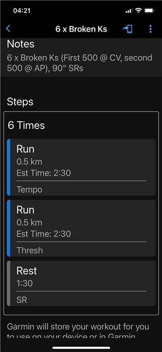

In this particular workout, which is basically 1 km reps,  ( but where you do the first 500m a bit easier then increase pace for the second 500m).  I programmed a 500m split followed by another 500m split then a 90 second rest. When done on the 945 and uplloaded it  to Garmin Connect it gives me the total km time plus the two 500m splits .. as seen in the first picture .
When done on the 965 it just gives me the two 500m splits but not the total 1 km time (see second picture ). I guess technically the 965 is uploeading exactly what was programmed , but it was a nice fearture in the 945 that now seems to be gone.

  • Can you screenshot the workout setup?
  • Honestly it looks like a bug to me. The screenshot for the 945 activity looks like it has "intervals" (sets) numbered and grouped correctly, while the screenshot for 965 looks like the "intervals" (sets) are numbered wrong and they're not grouped at all.
    I suspect it has something to do with the fact that you have two consecutive run steps in a repeat, and Garmin is handling that differently now compared to before.
    I created a very similar workout to yours, went through on my FR955 it by just using the LAP button to skip through all the steps, and I got basically the same (incorrect) results as you, both on the watch and in Connect.

  • As another example, I created the following workout:
    Repeat 3 times:
      - 1k run
      - 0:01 recovery
      - 1k run
      - 1:30 recovery
    You would expect this to show up as 3 "intervals" (sets) in Connect:
    Interval 1:
      run
      recovery
      run
      recovery
    Interval 2:
      run
      recovery
      run
      recovery
    Interval 3:
      run
      recovery
      run
      recovery
    But due to this bug, it shows up as 6 intervals:
    Interval 1:
      run
      recovery
    Interval 2:
      run
      recovery
    Interval 3:
      run
      recovery
    Interval 4:
      run
      recovery
    Interval 5:
      run
      recovery
    Interval 6:
      run
      recovery
    TL;DR I think Garmin just assumes every "interval" (set) consists of a single run step and optional recovery step now.
