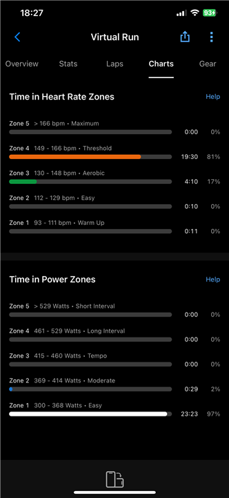

HR zone 3-5 but Running Power always Zone 1
Please help no matter what my HR zone is, no matter if it’s a tempo run threshold run… my Running power stays in Zone 1? How do I fix it? I tried resetting it and I get the same problem… how do I know what values I should manually put for running power? What tests could I do to get these zones? Any help is appreciated. I’m tired of seeing my running power always zone 1…
(Please explain any solutions the simplest of terms)
thank you!

  • You need to make sure your power zones are set correctly based on a reasonably accurate threshold power. If you don’t, they will be meaningless in relation to your actual effort.
    Did you set these yourself? My power zones auto detect pretty accurately (auto detect settings on) when I run outdoors.
    I see that this is an indoor virtual run. I’d recommend running outside, with auto detect on to detect your FTP and try from there. That’s assuming you haven’t done that already and these are the values detected.
