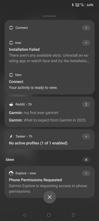

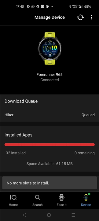

bug: "No more slots to install" when upgrading app
Bug in either fr965 or in the android Connect IQ app: when I have 32 apps/df-s/wf-s installed and there's an update to one of them and I try to update it I get error messages like: "No more slots to install", "Installation failed - There aren't any available slots. Uninstall an existing app or watch face and try the installatio..."
  • This is not a bug. It has always been the case that at least one slot must remain free for updates.

    I've been using Garmin watches since 2016 (since fenix 3 HR). I discussed this with product support years ago.
    This is how it works. It is "by design".
    According to Product Support, the behavior of the software is not a "bug" because it behaves the way the programmers designed it. The program code produces the result that was programmed. It is therefore not a software bug.
    The watches have a certain amount of memory and slots for IQ Stuff. You can use all the slots. However, updates can then no longer be carried out. If you want IQ updates to be possible, make sure that at least 1 slot remains free.
